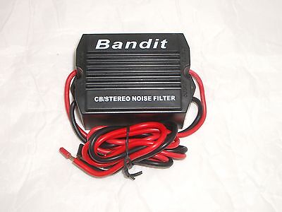

Since it changes with the engine speed I would suspect it's source is motor related. Alternator?? There are filters that can be put on the radio power wire that will help cancel electric related 'noise'.
