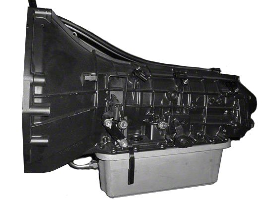

Dear members,
Would anybody know if the 5R55S transmission from a mustang (without Select Shift) can be built into a 2005 Thunderbird that has the Select Shift feature?
I imported the Thunderbird to Germany, and it is impossible to find a replacement transmission here with Select Shift.
Thank you so much.
Harald

Short answer is yes it can.
High performance 5R55X transmissions have been available for years from a variety of aftermarket American companies. Will handle up to 850 horsepower.
Or rebuild your transmission the way you want it.
Take a look at this short list and google for more.
Speed costs money, how fast do you want to go?
