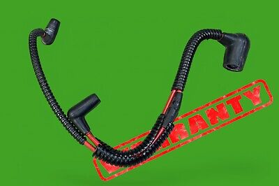

Can someone tell me where the vacuum line for this would go? The funny thing is (not really) the regulator on the car didn't even have a vacuum line connected. I am going to order one and replace it but really need to know where the vacuum goes.
The fuel rail pressure sensor senses the pressure difference between the fuel rail and the intake manifold. The vacuum line to the fuel pressure sensor and the EGR valve is located on the manifold behind the throttle body.

Awesome pics Doug. Appreciate it! Installed the new one today and fabricated the infamous vacuum harness that we can’t get any longer. After several weeks of work, I finally got to drive her around the block a few times. Can’t wait to spread the wings.
