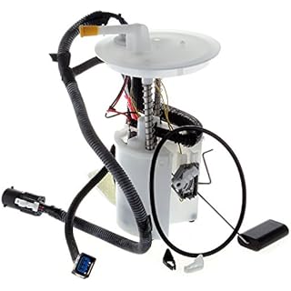

This is not a universal part, and you will need to get the exact part fitment. I think this is the part you need- https://amzn.to/2OLWqXZ This car has two pumps as well, make sure you read through that other thread for more information.

Here is a photo of the web site where I ordered my fuel pump many months ago. Got it from partsgeek.comT Bird fuel pump.JPG
