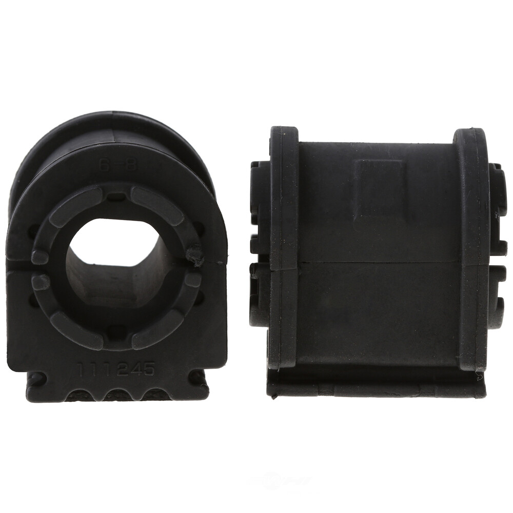

I've got the same creaking and groaning going over the speed bumps. I have new tie rod ends.
My neighbor is a professional mechanic and ventured a guess that it was the front sway bar bushings. If you can get to them, maybe try some dry lube or silicone spray? I haven't tried.

Possibly, but I got brand new tie rods and sway bars installed on her prior to picking her up at the Ford service department in California. It could definitely be the plastic behind the dash creaking, but no matter how slow I go over speed bumps it always squeaks and groans. In my opinion, something in the suspension needs to likely be lubed as it is probably just dry rubbing that is making the creaks more pronounced?
