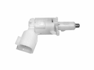

Moderator Update- See this page to purchase a new switch- https://forums.fordthunderbirdforum...r-switch-xf2z14018ad-for-warning-lighr.12993/

I'm having the same problem with the door ajar light. Where are the sensors? I didn't think they were in the latching mechanism of the door.
The door latch mechanism is separate from the sensor (just a switch really):
You can get MANY of the door and dashboard switches/components from places like CariD, etc for a fraction of the dealers price...
You have to get inside the door to deal with a bad sensor:
The front door ajar switch is attached to the front door latch and can be replaced separately. See item #10 on the attached front door locks and latches exploded view. XF2Z14018AD is the part number of the door ajar switch and the cost is around $56.00.
I also included the procedure for removing the door ajar switch in the attachment.
