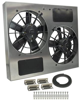

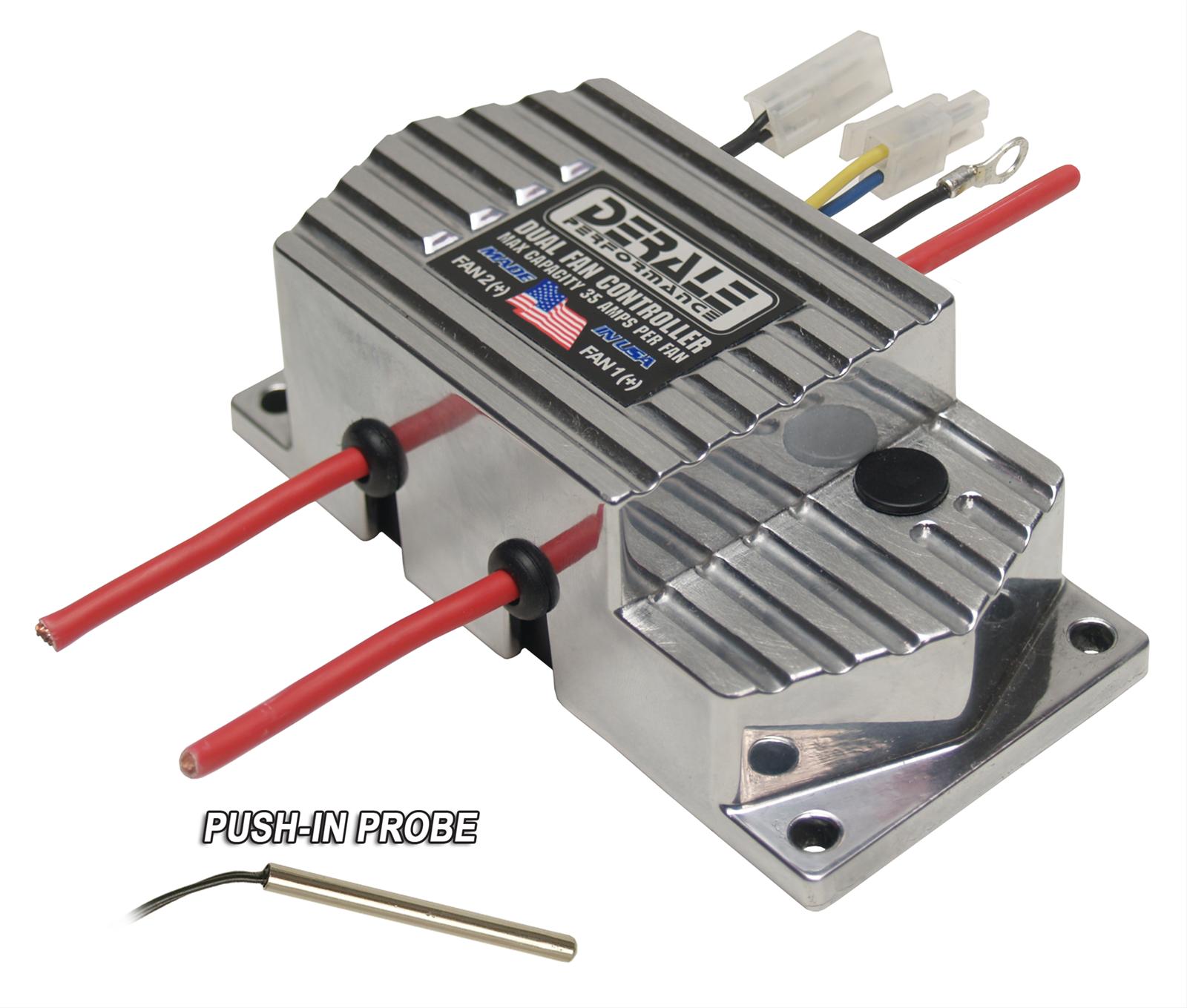

Repairs are moving right along and as of 8/20/22 all suspension parts are in, The alternator, hydro pump, fan and Radiator have been removed. I'll start the suspension repairs this week and in the meantime I'd like y'all's thoughts on the options I picked for the cooling system and what I'm planning on doing with the hydraulic pump actuator solenoid. Alternator will go to a local shop to up the output amperage.
Thoughts on an aftermarket system over a somewhat stock system.
The H.P.A.S. being removed from the pump and hooked back to the electrical plug and placed in a secure area, hopefully on top of the engine compartment.
New stock radiator, can not find a Motorcraft so will go with an aftermarket
Aftermarket Derale high output dual fan and shroud
Aftermarket fan control with radiator probe.
This will be a South Texas car and it's hot so I'm leaning towards a duel fan system with a separate control from the car. One fan will run when the car is on and the second will run when the temperature increases.
A bad thermostat was causing my intermittent overheating issues on my T-Bird. Once I replaced that (and the Coolant Control Valve that had a mechanical leak), she's been running great even in the Texas heat.
Your 2002 has a slightly different cooling system than the rest of the Retro years with the hydraulic fan, and there's definitely topics here about replacing it with the later model electric version. You really should NOT need a dual fan system even in south texas, the stock cooling system with single fan on mine has been fine it's entire life, even in 100+ degree heat in the desert, and running 10+ hours on road trips. This car does a good job regulating the heat- you should still hear (and feel in the hoses) the water pump circulating fluid through the engine even after you turn it off when it's hot. It'll run until it's cool enough to turn off- not sure the time there, I'll have to try to remember to time it. I hope you have someone very knowledgeable on this engine either helping or doing the work if you want to change so many things from stock.
My next projects are the fuel filter, bleeding the brakes, and a shock/strut replacement. Ride isn't rough yet like you describe, but I'm sure the suspension system needs a bit of TLC after 18 years and 50K miles! I'll try to remember to take pictures this time as I'm doing the work.

As answered by the moderator, I have a 2004. Most of the time, I don't even hear the fan operating, only rarely will it go into a high-speed mode. Of course, mine is operated by the "magic" in the electronic control system.
