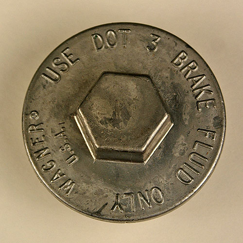

I have had the car for a year (1957) and thought I'd check the brake fluid. I put a cresent wrench on the reservoir cap but the cap would not budge. First, should I check it ( opening creates issues?) and second - off is lefty loosey - correct?

Absolutely, check the brake fluid. Make sure the area around the cap is clean. Given that the cap is so hard to unscrew, it probably has not been off in awhile, who knows what you might find in there. And yes: righty tighty, lefty loosey. When viewed from the top, the cap loosens by turning it counter clockwise. I would suggest a box end wrench (and maybe a cheater for a little extra leverage) as opposed to a crescent wrench, so as to not round off the corners of the hex.

Doug, thanks so much for your thoughtful reply. A box wrench is a great suggestion. Much appreciated!

Agree with Douglemmo. I'm not familiar with what the top looks like on that car, but another possibility might be to use an oil filter wrench, one of those that constricts as you twist it.

A pair of channel lock players works well to. My 57 has a plastic cap and looks original, so it is probably just a little too tight.

Hi and following up. I got the box wrench and the cap came off without much drama. The fluid is at level and clean so i’m Good. The shallow threads mean cross threading is a potential villain. I was very careful engaging the threads. Don’t expect to do this often. Thanks to all you helpmates for the assist!
On my ‘64 the reservoir is metal so you can’t see fluid level without removing the lid. I’ve always kept a close lookout on my cars for signs of brake fluid leakage around the master, at the wheels etc. but I completely missed it when the reservoir on the ‘64 leaked into the booster and the brakes went spongy. I’ve heard of this happening to others and causing brake failure. So checking reservoir fluid level once a month or so is SOP for me now.

A plastic cap was not original on the '57. I'm surprised somebody found one. My cap was on so tight I mangled the nut on top getting it off but I eventually did but had to buy a new cap. Put a little PB Blaster oil on the threads to prevent them from freezing up again.
