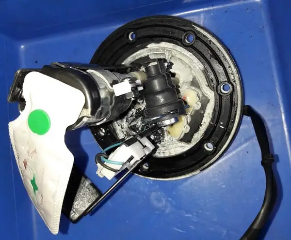

2005 new fuel pump, no pressure. 12 volts to pump and can hear it run
I am going to assume you have changed the filter, it looks like you have tried 2 pumps with same results and not sure what the original pump was doing I would look at replacing the fuel pressure transducer. The pump running at 3 psi is controlled by the pcm based on the transducer signal, if you believe it's a defective pump get a ford one or a Lincoln ls, I only use Airtex pumps and have never had a problem.
