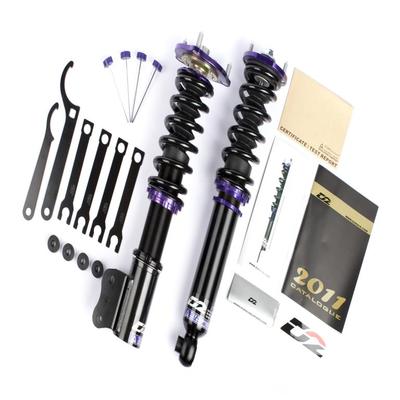

You won't find the H&R anywhere. This is the only thing sold now as of 2025-
