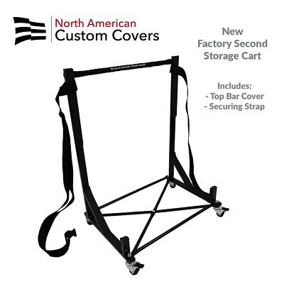

Hot weather is now history in Tucson, so the time came to remove the hardtop. Several months ago, in preparation for the event, I purchased a hardtop caddy from Amazon. Assembly was easy and the finished caddy appeared well made and strong. Got my top removal team together and lifted off the top from sides carrying over the trunk (which I padded) and set the top on the caddy. It came with a retaining strap to secure it and a cover to protect the top from dirt and dust. Rolled the caddy against the wall and it moved easily and securely. Surprising was how little it stuck out (19") from the wall as can be seen in the photo next to a metal storage rack. I recommend this unit, and it appears to be a good investment.

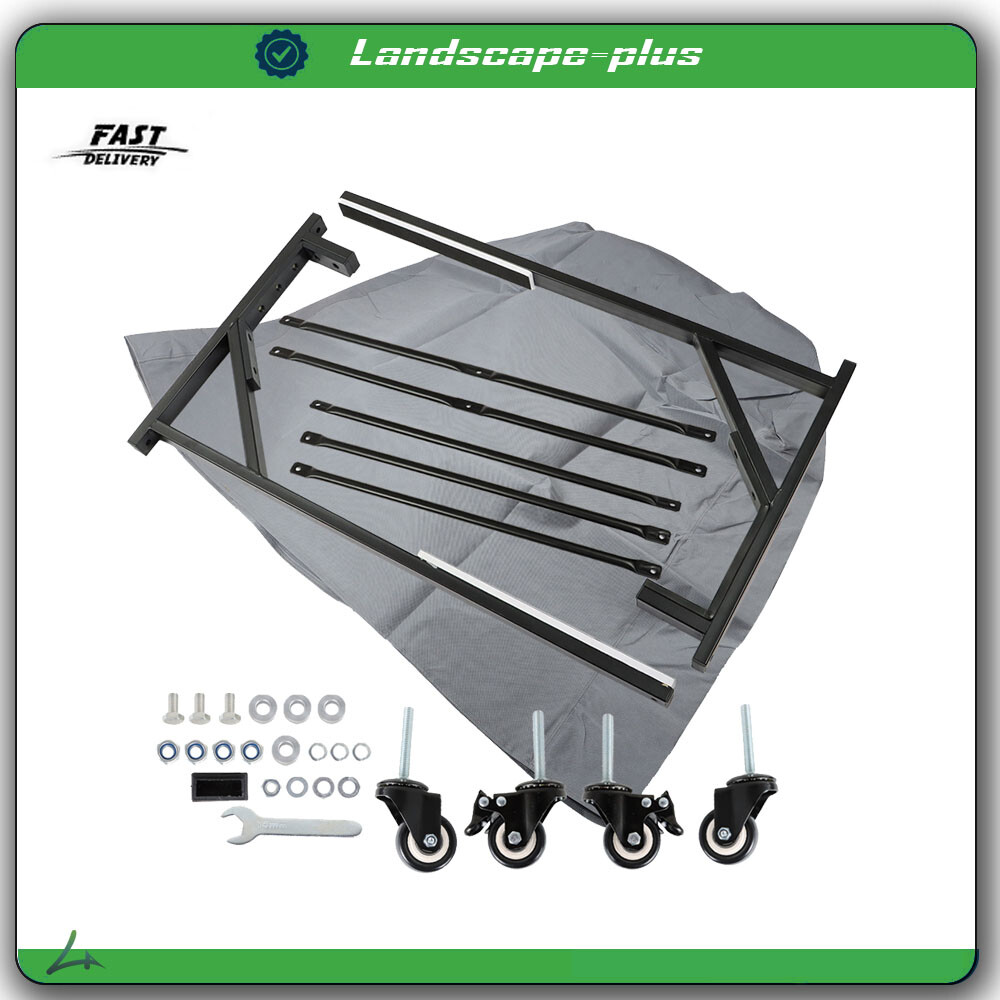

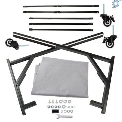

I have one similar, when not in use I disassemble it and assemble it to store the hard top, it does the job of course I would prefer the OEM.
JoseG, thank you for the reply! I’m glad that you find it adequate for the job. I see that the prices for an oem stand can be rather high, unless one happens upon a good deal. I will probably order this replacement stand before something bad happens to the top, when someone unwittingly knocks it over in our garage.
There are many after-market stands for hard tops on eBay, they appear to be universal, not specifically targeted for the 2002-2005 Thunderbird. They are about $90, and include a storage bag. I don't want to spend a lot on the oem stand, just need this to store the hard top in the garage.
Has anyone bought one, and if so, what are your thoughts on these?
Here's an example: https://www.ebay.com/itm/3043729440...pid=5338236430&customid=&toolid=10001&mkevt=1
Most people's buy the hardtop caddy shown above. Considering the top is worth 2500++, why get the cheapest one?
I recently bought one of those stand off eBay for $ 60.00. with out the cover. The stand works well so far. It was cheaper because of the paint job on it, it was flawed. I know how to use a rattle can.
