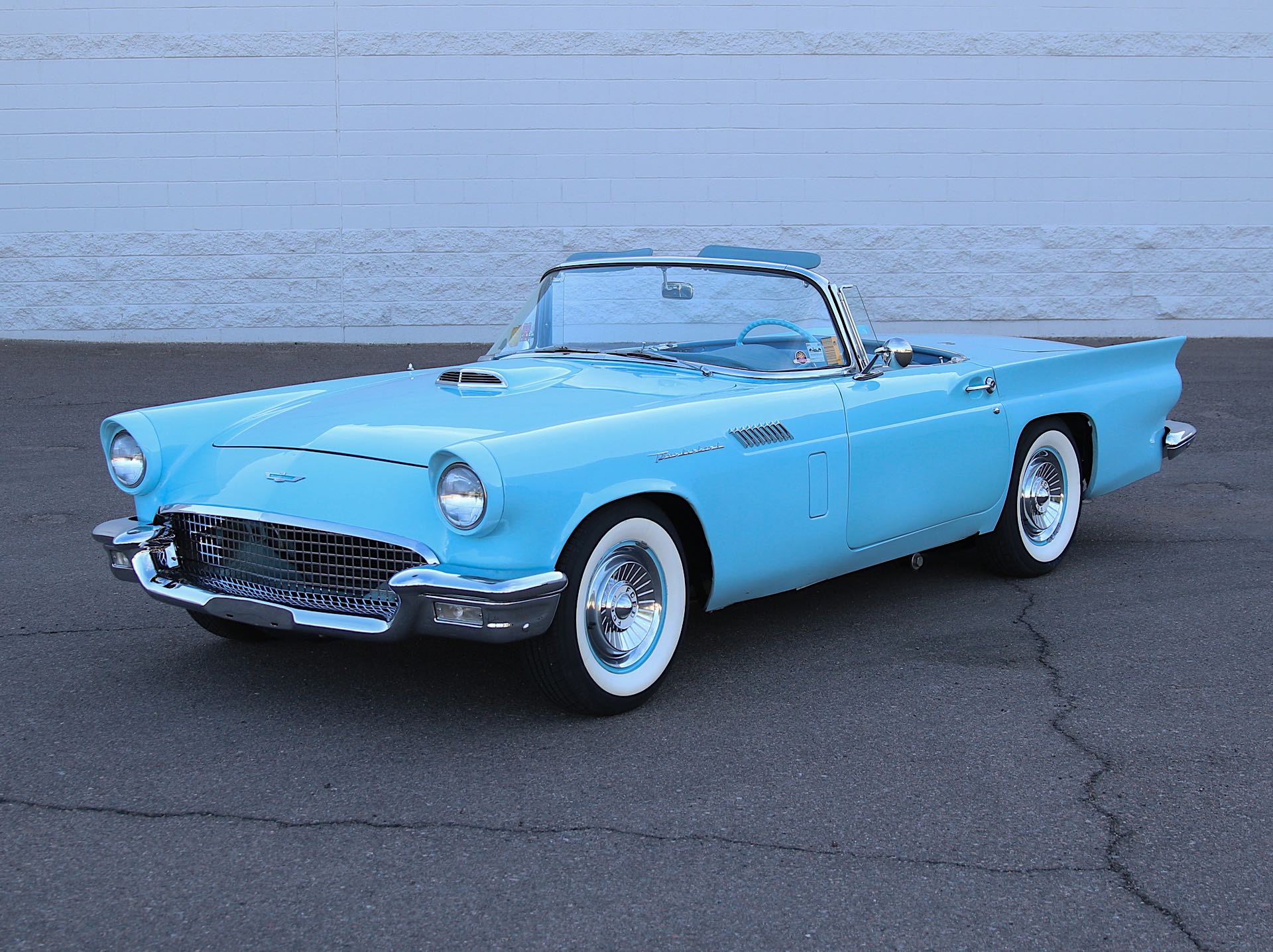

I watched this auction a few weeks ago. Awesome restomod and yes, it has an air suspension!
Wow, This builder is apparently my clone as he tips his hat to modern tech just like I am planning, right down to the gauge package in the original panel and Sniper II EFI...

That was a nice modified T-Bird! I am sure who ever built it originally lost a ton of money as it only sold for $35K. I see way more than that in mods.
If you look closely, the body work held the price down on this one.
