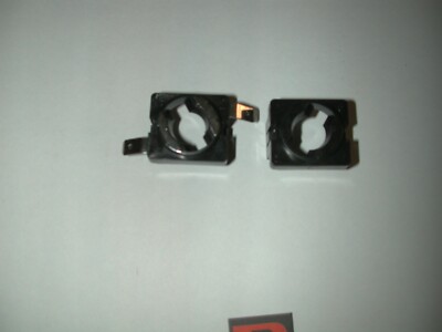

That said, what makes you think the bolts are missing at the front? If you cannot lift it from inside where it attaches at the windshield header, it’s most likely bolted down. The bolts are designed to stay in place with the hardtop off. I’m attaching pics of mine with hard top off. Notice they can be pushed down into the header so the soft top can be latched into place. But they do not come out the bottom....or at least they shouldn’t. Also pic of the factory tool for the bolts...torx...and easy to find replacement if yours is missing,

Thank you so much I have seen those tools available on ebay I thought there was a screw or bolt that tool used and then inserted into the hardtop it appears from what you're showing the screw or bolt is permanently recessed on the car and you need that tool to push it up and lock it down, now I'm really considering picking it up Monday to drive it back to Tampa as I don't think they have that tool I'm not sure if something like that could be picked up at Home Depot or if a flat head or Phillips head would temporarily get some of the threads that connect? It looks like from pictures I took of the car I might have the bolt recessed in one of the pictures

You Can certainly get a replacement tool off eBay, but if you have a Lowe’s/Home Depot/ harbor freight close by, pick up a variety pack of torx screw drivers 6-8 inches long, less than $10, to get you through Monday pickup. You’ll be glad you did. Then follow the top on/off process outlined in the cd that came with the car, or read the “lots of noise” post below for proper procedure. The top weighs 83 lbs so be careful cause it’s incredibly awkward to hold and lean in to get the back part in place. I recommend two people to hold, and one more as a spotter until you get comfortable doing it. Like most folks, mine comes off in the spring, goes on the rack in the garage and back on the car late fall. Where you are you might not want to put it on ever again once you get it home.

Message this guy on eBay, says he has the screws and tool in this listing description.
