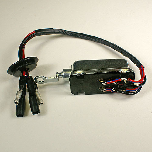

A modified neutral safety switch is available from at least one vender that will allow to start the car in either park or neutral. Of course the dangerous trick is to bypass the switch so it will start in all positions.
This the new N safety switch just got it out of the box and noticed the wires, where there soldered would be exposed under the car. So before I install tomorrow I coated the connections with plastic epoxy letting it cure overnight. Just didn't like the dumb idea having those connections exposed especially under the car.
Had to splice all 4 wires the car harness had all 4 male ends and the new wires on the switch the male ends didn't fit. Either too small or too big couldn't tell they just wouldn't snap into each other. Just a heads up.
