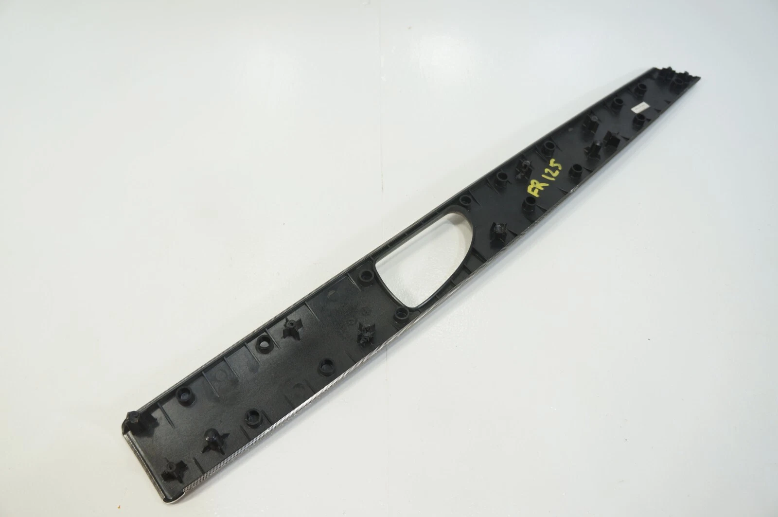

Hi there!
My weekend project I've decided is going to be refinishing the brushed aluminum by wet sanding down the entire brushed aluminum panel to repair any seatbelt dings and dents on the drivers side and passenger side door bezels and then polish them back up.
I want to remove them off the door to get a very even sand across the entire piece if possible and protect the surrounding plastic. The plan is to polish and wrap the the final peice in clear vinyl to protect from seatbelt dings in the future and to reach the manufacture gloss level once I am satasfied with the sanding job. My question is, where are the clips located that holds the aluminum peices in as I want to be careful to pry gently in those areas using pry tools. I know it is possible, as on Ebay and Thunderbird Specialties they sell replacements for this aluminum bezel trim that appear to snap in once you remove the old one, I am just worried about breaking the clips by prying the wrong area.
Does anyone have a door panel schematic that shows where the clips are for the aluminum bezel? I will post my results of the re-sanded and polished peice after I get out those unsightly seatbelt dings and reinstall it! 🙂
**Note: Don't do this on any year other than '02 as those later years have actual designs in the aluminum as opposed to just a brushed look that is easy to replicate.
I have attached a photo of the back of the drivers door panel. It is layered, and many of the connections are plastic tabs
that are melted down to hold the panels together.View attachment 32345
Does this mean the aluminum bezel does not come off? On ebay, it looks like there are snaps on each corner, and then little holes as well that slot the bezel into place?
The bezel will come off, I had to better secure one of mine. You have to pry away the layers to get to the melted plastic
posts that hold on the trim piece. Once you have your replacement piece in place, you can secure with small screws,
or try and carefully remelt the plastic posts in place. Takes time but not hard.
