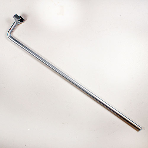

I think there is a thread on here on how to open the hood from underneath but you would have to get it on a hoist to be able to get to the lever with something to push towards the firewall to release the hood. Then the task of replacing the cable and figuring out why it's so hard to release.

To use that tool you have to lay under the car, instead I ran an alternate wire from the latch to the inside of the car using mechanic's wire.
