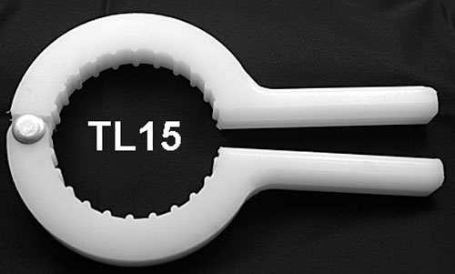

Make sure that you are turning the chromed collar in the right direction. The collar must be turned clockwise to loosen. If the chromed collar is too tight, usually from someone turning it the wrong way, CASCO sells a tool to loosen it. I know the tool is pricey, but not so much compared to a new chromed collar.

Well I was able to get the collar to turn using a strap wrench. Still quite stiff, hard to turn . Must use 2 hands or strap wrench. When it is rotated what appears to be all the way, you can feel a solid stop point left or rt, I tried to pull wheel out and push in but it wouldn't move. I'm reluctant to to force it. Is that all you do is pull or push. How do I know if it's in or out now. Does anyone have a pic. of the relationship between the wheel and the collar when in or out, Any idea on how to get it to move?
