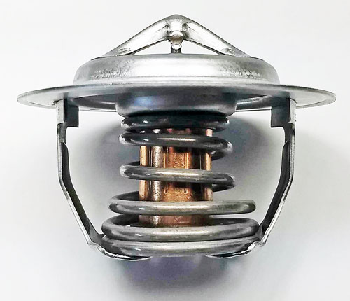

p.s. where do you get the wider opening thermostat?
CASCO

I installed the 6 blade fan, better radiator, and high output water pump. She now runs at 60% (gauge) on hot days, 45%-50% on cool days, and never hits 95% on hot idle like it used to, maybe 80% on the gauge on a 95° day.
I heard on here NAPA has the wider thermostat. The only issue I've heard of is that the heater valve may interfere and the thermostat may not open the whole way. Just need to check the interference issue on shortening the pipe in the intake manifold. There are many conversations on here about that.
Yup, shortened mine. Also installed the modified spacer.
