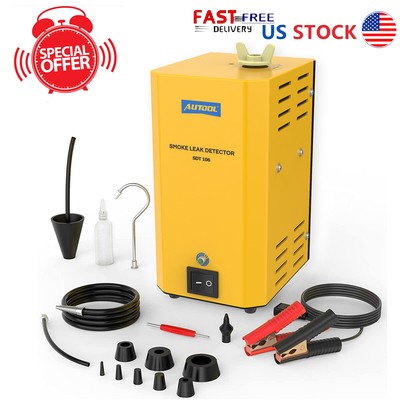

Get you one of these smoke machines, will help show any leaks. With our T Birds 20 years old many
rubber parts are drying out, and or cracking.
Moderator note- post links to products, not screenshots.
