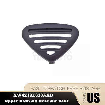

As the title says, the small triangular dashboard vent cover (there is one of the top right and the top left of my dashboard) for my 2005 Ford T-Bird just popped out, and I cannot put it back in. There were three tabs at each point of the triangular-shaped vent cover, and two were broken. I guess the force of air through the vent cover must have caused the breakage, who knows!
Anyway, I did a quick search on google, and did not find anything.
Has anyone else had this happen to them?
Also, I assume that since this happened 2 1/2 years after I bought the car, it is covered under warranty, is that right?
Also, I assume that I can get the part from my local Ford dealership, and even if it is not covered under warranty, it probably only costs a few dollars, correct?

MODERATOR UPDATE: Order replacement here-

Thanks, George. I will be heading to a close-by Ford dealership this morning. Worst case scenario, I can always super-glue the triangular vent cover with the two broken clasps (they are on the inside, and so you would never see them anyway) in place onto my dashboard.
I agree, glueing is always an option but only after warranty. Not sure what part of the country you're in but I would bet direct sun may affect some glue/adhesive
Actually, they should be replaced to make it right. :cool: Let us know the outcome and part numbers replaced

I had the same problem with my 03 bird; again, for no apparent reason. I bought a new vent at my Ford dealer. However, I don't remember the cost.

When I bought my 04 the vent was missing. I ordered a new one from the dealer and it was less than $5.00.
New one fit fine.

My driver side vent popped out and all three prongs were broken off. I just order one from the part department at the dealer. It cost me $12.

Just had the Defroster Grille Pair pop out on my 2004. 1aauto had them as a pair for $35. The local ford dealer had them at a two day order for $10.25 a piece. I was going over a rumble strip in a construction zone when mine popped out.

I was able to purchase one from my local ford dealer about year ago about 15 bucks
