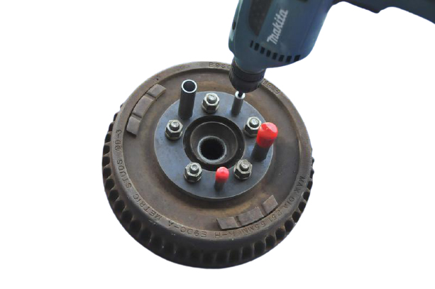

One option it to re-drill you stock rear hubs to the 5x4.5 lug pattern. Kits are available on line for about $200

Another option for the rear 4.25" to 4.5"(108mm to 114.3mm) conversion, since it's still the least simple....(especially with drum brakes)

I agree drilling the stock spindles is a more cost effective option vs swapping out the spindles. I looked at the cost of drilling vs spindles and it was about $80 to $100 depending on how many drill bits I needed. I wanted the option to upgrade the brake calipers to Cobra parts someday in the future.
A couple things to take in to account If you drill the stock rotors or brake drums to match the bolt pattern, you will have an issue getting replacement parts in the future. You could still do the Cobra rotor swap and upgrade the brakes that way. I would also consider the mileage in the vehicle - if you have a high mileage car, you may want to to replace the rear bearings and if you got that far apart changing the hubs makes sense.

No worries. The FTB spindles look great & are a real bargain. The drilling guide is something I saw on a youtube channel, and the one I posted comes with drill bits.
