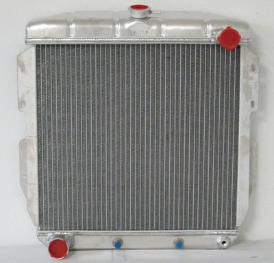

Similar question on the radiator. If you have not already bought one consider the below. Myself and several others have bought them and they cool much much better than the original and as well or better than any of the others on the market. It fits perfectly and if you paint it black looks just like the original. Price is a steal too.
