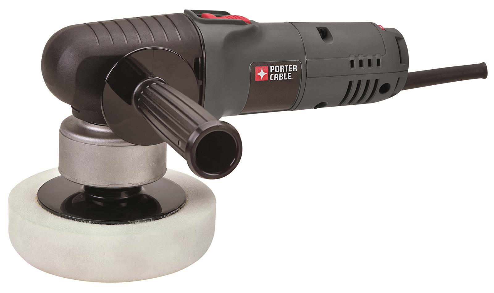

followed by a Carnuba wax will do wonders. The Porter-Cable 7424XP
is perfect for a hobbist and won't get you in trouble (e.g. burn through).
Avoid those Harbor Frieght or other El Cheapo buffers. Cheap components and inconsistent
operaion. Rotational speed and technique are critical and the instructions for the above buffer will lead you through the process.
A session with that buffer and Macquier's Ultra Glaze will yield amasing results.
Follow it up with Griot's Best of Show wax or an equivalent "Chemical Guys" product.
The same buffer above with the proper speed and pad can apply/polish the wax.
