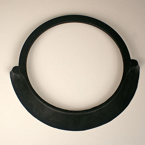

I am putting a new Powermaster high torque starter on my 57. Do I need to get a starter seal to put on with it as there seems to be slight gaps at mount? Share pictures of your new high torque starter install and any tip or directions for this installation.

The mating surface is the ground path for the starter
If the is a gap, I would investigate why
The original starter did not have the seal on it, so I not sure if is supposed to. The new starter bolt holes line up to the mount holes, but the base of the new starter has slight gap at side and bottom if you look closely at the mounted picture with the new starter on. Do I have this on correctly?
It looks like you have it in correctly, I would not worry about the gap unless you are planning some serious off road traveling. Once you have everything working if the gap still bothers you a little clear silicone will seal it up.
Yep, I spoke with Powermaster Performance today, really helpful and knowledgeable tech support. The 9002 high torque starter is very much made specifically for Y block install and is pretty much a bolt on application. The rubber starter seal will fill that 1/8 gap, or you can use a sealer or even use some stick foam weather stripping around it. The seal is just a dust boot for the starter placement. So as harley said, unless your going off road or through big water puddles it's not a big issue
