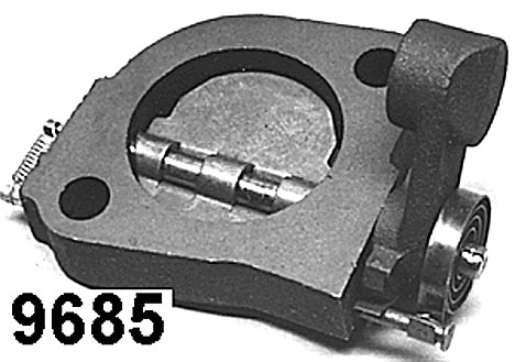

Any experience with pre-formed exhaust systems from the usual suppliers CASCO etc.? I will go with resonators and the heat shields that bolt onto the top of the mufflers. I'm sure it would cost less than having them formed from scratch by a local shop. I'll also replace the heat riser valve when at it.
Hey @Ward 57 . I was looking at the heat riser in a few different places online and it does say…this valve is not needed if you don’t drive the car in cold weather. I may start my cars in the winter once in a “blue moon” but they won’t see the any drive time. Just knowing our conversations, your vehicle will not see those conditions either….maybe consider eliminating it?
Naww, I want to keep it as stock as possible and I see no downside. I park my small rider mower in the front of the garage so I can take my car out any time. I do drive it in the cooler fall when I have an excuse like getting to the mower and don't want to have to deal with warm-up issues. I guess it's the same with the hood scoop block off but I'll never use one.
I eliminated the heat riser a few years ago when I did the engine rebuild and honestly can’t tell any difference in warm up times.

diddo on leaving the heat riser out, I used the spacer as well

I got rid of the heat riser in both of my YBlocks(used the spacer in place of it). Didn't really see any difference in warm up times.

Well I found the heat riser is unobtanium and new ones are on a slow ship from who knows where. So the fellow who is replacing my system is just going to disable my current riser and I've heard no negative results. Original part but not needed to be functional. Found some interesting automotive archeology in the process.
