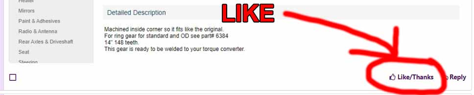

Use the like/thanks at the bottom of the post to thank a user.
