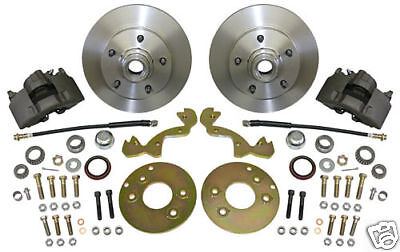

I have a 1956 with Kelsey wire 15" wheels. I bought a kit on EBAY fpr $514.99 that included freight from Performance on line PN 160958173557.
It is a complete set. NO INSTRUCTIONS are provided so its like a puzzle. You pull everything off your front spindles and start figuring out what fits where. No holes to drill or filling to fit it all bolted up in 3 hrs. And a 6 pack. Has been on car since last fall and works great. I did not change master cylinder. Factory one cavity still on this car. New rear brake hoses as old ones plug up internally. i turned rear drums at that time. You may down size rear wheel cylinders one step if your car has to much rear brake. My friend did but I did not. This kit is not advertised anywhere. Kit fits 1955- 1956-1957 !!!

I have plenty of brake power. With new hoses, turned drums , real good shoes car stops very well. I have arebuilt power brake unit hung on the car but it stops so well I never hooked it uo.
