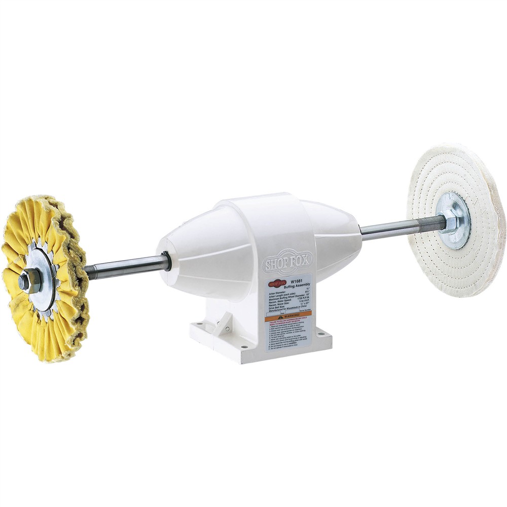

I have a pedestal buffer with a 12” pad on each side…one is for fine, the other side is for super fine compound. The drill can work but may stall with any pressure
I made up my pedestal buffer with an extra electric motor and a pedestal frame. Mounted the whole thing on the top of a recycled kitchen cabinet. Supplies are stored on the shelves below. The 12” wheels are cotton and about 3” thick. As soft as they are, they spin fast enough to become fairly rigid and should you catch an edge, it can pull the item right out of your hands. But they are capable of producing a very professional polished surface.
Mine is about 20yrs old and as I see now, about 1/2 the cost. Still may be worth it if you’re a tinkerer
https://cdn0.grizzly.com/manuals/w1681_m.pdf The motor mount eliminates tension adjustments
