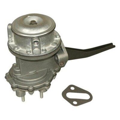

My fuel pump seems to have stopped working. While driving, we went over a bump and the brass reducer/adapter that attaches to the output fuel line from the pumps cracked. It banged against the frame/cross member (looks like on new pumps, the outlet has been offset by 90 degrees to fix this issue)
I replaced the adapter, hooked everything back up and it would not pump fuel. Pulled the fuel pump out and took it completely apart (pain in the rear end to put the internals back together) and when I actuated the arm, I can hear "sucking" noises, but when it's installed, no fuel pumps. Not sure where to go from here and want to do a little trouble shooting before I buy a new pump.

Buy a airtex pump ,you will not regret it.

If you have a USA, Canadian or Mexican made pump you are better off geting it rebuilt than a new one. Most new ones are worse than your bad ones.
