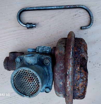

Rick: Did you do this retrofit in your car? I think the booster installation is easy, but not sure how easy is to move the battery to the trunk.if you're talking about a remote booster like original I found an aftermarket on Amazon. $180. bux Personally I've been thinking about putting the battery in the trunk and mounting a regular dual system master/booster at an angle where the battery was.
