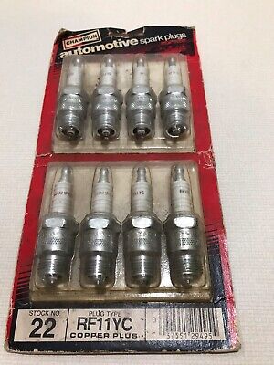

I have a 1955 with the 292. What are the current spark plugs you are using?
My plugs are the RFI4YC and they are really carboned up from my carbonator needing rebuilt. I have rebuilt it and am doing the plugs now.
Autolite 46 was what was in mine. They looked good when I checked them but I replaced them anyway with new Autolite 46. If you have petronix ignition gap the plugs a little wider than the factory spec. I'm sure there are other acceptable plugs but I prefer something in the 'ford family' of products.

4. The RF14YC plugs you’re running are actually a hotter plug than the RF11YC, if I’m not mistaken. A colder plug should foul easier at normal timing. We used to run colder plugs for racing so we could advance the timing.

Looks like I will get the Autolite 46.
