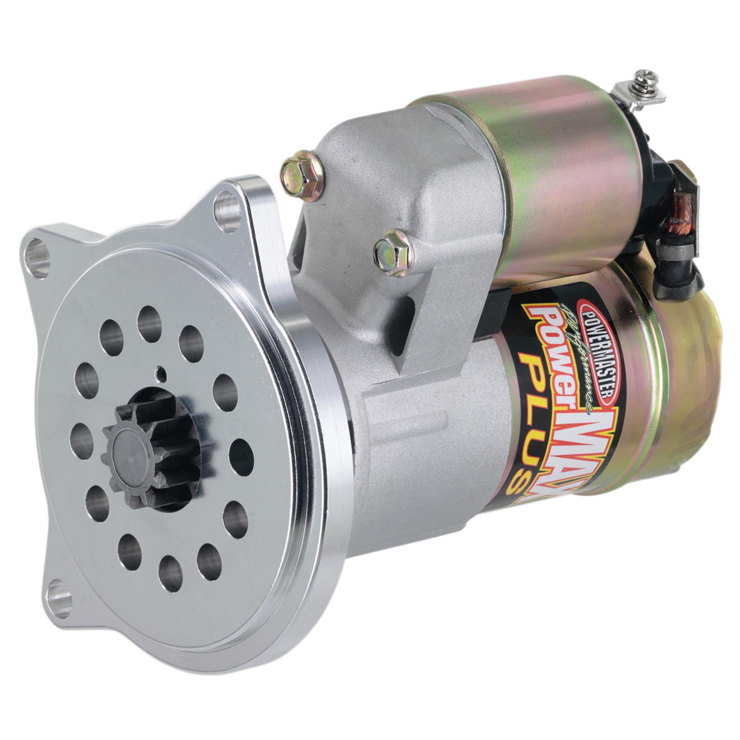

Found this one which might be the right one.

Hey guys so the starter motor is coming to the end of its life had a lot ofbsmoke and sweet metallic smells trying to turn the engine on. Has anywhere here got a powermaster starter which is what I'm looking at atm on summit racing. One or the other
https://www.summitracing.com/parts/pwm-9106
Or should I get the same style as before.
