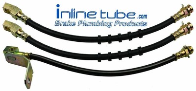

I’m seeing a lot of issues where the rear flex hose gets swelled or clogged stopping brake fluid. My plan is to start there and work back to the front to find out if it makes it there or if it’s stopped somewhere before this. Replacing all rubber hoses as well.
