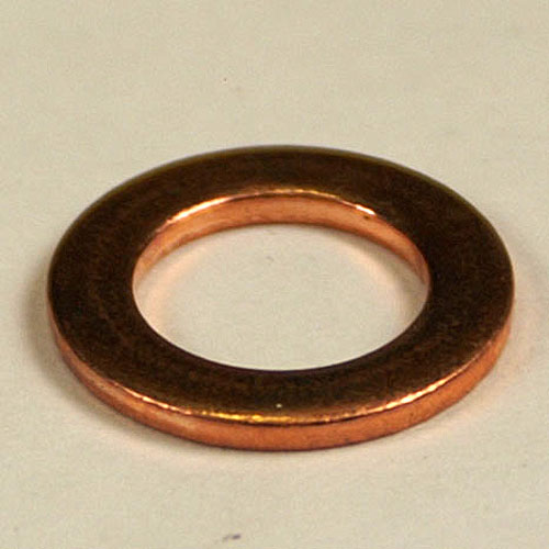

Where the lines require the brass sealing washer, they may be included with the line. But you should be able to get them locally.
