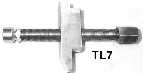

This is the tool that I use to remove the damper pulley. It works like a charm.
doug7740
1955 Thunderbird Blue
I know this is the tool for Thunderbird dampers. I have two. I do not know if it also works for passenger car variants.
Thank you for sharing this link to the damper. This is news to me and good news.
As doug7740 said this is a great tool. I would check with a supplier like CASCO or others to find out if it works for passenger car dampers. I hope it does. For T-Birds it is the best and only one that I know. It really does work like a charm.
The sedan damper is a different thing altogether and the tool shown will not work with sedan damper.
When setting up to pull the damper, take out the bolt and washer and reinsert the bolt w/o the washer. This protects the threads in the crank and provided a good footing to the center piece of the puller.
So many people forget this simple process. Whether it's pulling something off a stud or having to pound out a fastener from the tread side if you want to preserve it. Thread chasers don't like mushroomed ends.
Thanks for such valuable advice. I have purchased (eBay) this tool to pull the damper, and now I will definitely use the bolt to sit the puller core.
