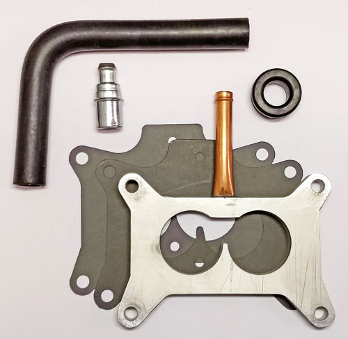

I believe what you described could be done. Another option is to visit the usual vendors sites and take a look at the PCV conversion kits they sell. Using a kit is likely to present a neater appearance then the other approach.
This is the kit for the 2-barrel. It includes instructions.
Unfortunately my down draft tube is on the driver's side of the motor, not at the rear of the engine. This won't work unless I change the valley pan. Anyone have another suggestions?
Yup, from what I see on "the internet" the preferred method is to get a valley pan with the rear road draft tube setup. That said, your original method would still work, it just would not look as nice and you'd have a bit more tubing running around.
