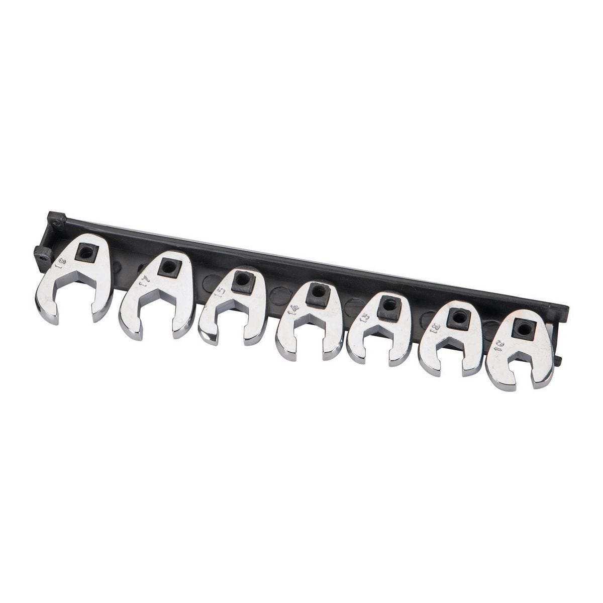

Perhaps a crowsfoot socket would do the trick. https://www.amazon.com/YIYEIE-Crowf...-Piece/dp/B0BQ1NG6FF/?tag=thunderbirdforum-20
