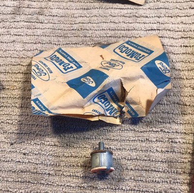

The original socket used a sort of resettable fuse that screwed onto the post on the back, and the hot wire then attached to that fuse. If you swap to the new style, be sure to put in some sort of circuit protection on the hot wire (e.g., inline fuse in the wire), or you'll have a hot wire from the battery with no safety mechanism (i.e., a fire hazard in the event of a short due to chafing wire or the like).

I found 2 sources for a fuse that screws onto the threaded posted at the back of the lighter socket. Neither has a circuit-breaker reset button. If they aren't compatible with the Casco socket, I will add an inline fuse.

Look for part number FEW-14429-A. It's not a reset *button*, it's a reset *recess* (insert a paper clip to reset). Just a hole in the rear of the case.
Several available on Ebay.
