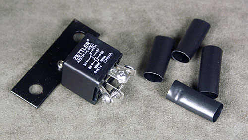

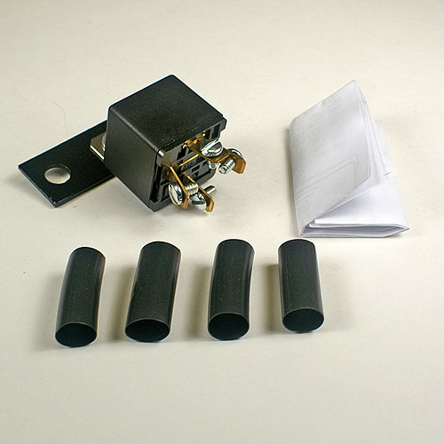

The part that you are looking for is the power window relay. This is the same relay that is used for the power seats. Most Thunderbird suppliers carry this relay, however the replacement does not look like the original one.
This is the relay if your Thunderbird is still 6 volt:
This is the relay if your Thunderbird has been converted to 12 volt:
