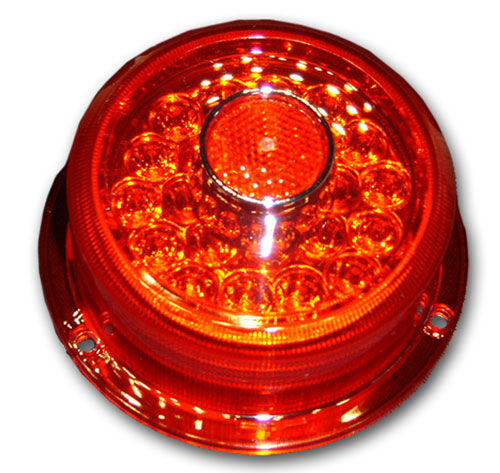

Hi, all,
I’ve got a 1955 TBird still on the 6V system. I don’t want to change it, but I do want to find a way to keep the original look of the headlights and taillights and increase the brightness/intensity of the output.
Ideally there would be an LED replacement set but I can’t find a 6v one.
I appreciate any help or recommendations.
Thanks
Hi, all,
Thanks

If I replace Headlights & Taillights, IS there a viable 6V LED option? Do I have to also replace the headlight switch? IS it there a good choice for a High output or Halogen 6V replacement? Headlight and Taillights same questions.
Thanks
If I replace Headlights &IS there a viable 6V LED option?
Also, should be DOT approved to be legal with many local/state/federal laws. If you put an LED bulb in a halogen housing and you are involved in an accident, you could be held responsible for the accident if the other party can demonstrate you blinded them.
