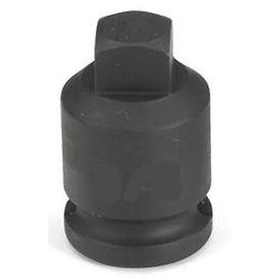

The 5/16 drive adapter can be bought at a specialty tool store (if you're lucky enough to have one nearby) or on line No need to make one unless you like that sort of thing. Also i’d worry about changing the strength of the metal by grinding down a 3/8 drive. Here’s one on eBay.
Except he’s not looking for hex drivers. Those have 6 sides. He’s looking for square (4 sided) attachment if it’s like my old Fords.
Ebay had a 3/8" drive socket adaptor with 5/16" end. Cost was $9.14 including shipping. BTW the 3/8" one I ground down was a really soft metal after grinding!!! Good thing the plug came out fairly easy!!! Hope this helps and thanks to all who helped me. Happy New Year yo'all!
