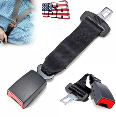

Get another male end, the end on the belt strap, and clip it into the seat connector. This will make the connection to tell the computer that the seat belt is fastened. These male ends can be picked up at a salvage yard or any junk car. Likely any model would have the same seat belt connector/buckle.
To test this, try clipping the opposite side belt into the buckle, f it will reach .... The legal part here.... Do this at your own risk;)
Maybe one of these...
or...
