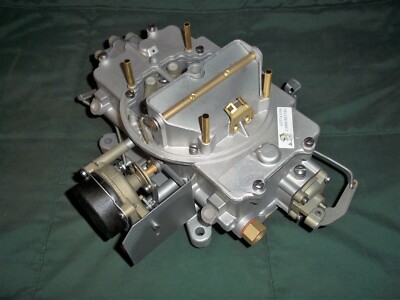

I've had dual quad setups, and single carb setups on a dozen classics. It is ALWAYS better to restore original equipment ir a period correct replacement if that applies, with few exceptions. Replacing a factory engineered setup with one of those Edelbrock or Holley "generic" carbs is almost always a compromise in performance. Then you have to deal with linkage and fuel line mods, often hood clearance, choke configurations.
Send your carb off to be rebulit -- there are dozens of competent shops that do this work.
I do my own rebuilds (see picture) but not everybody has the temperment or attention to detail required:
Maybe consider a quality, correct, restored replacement:
