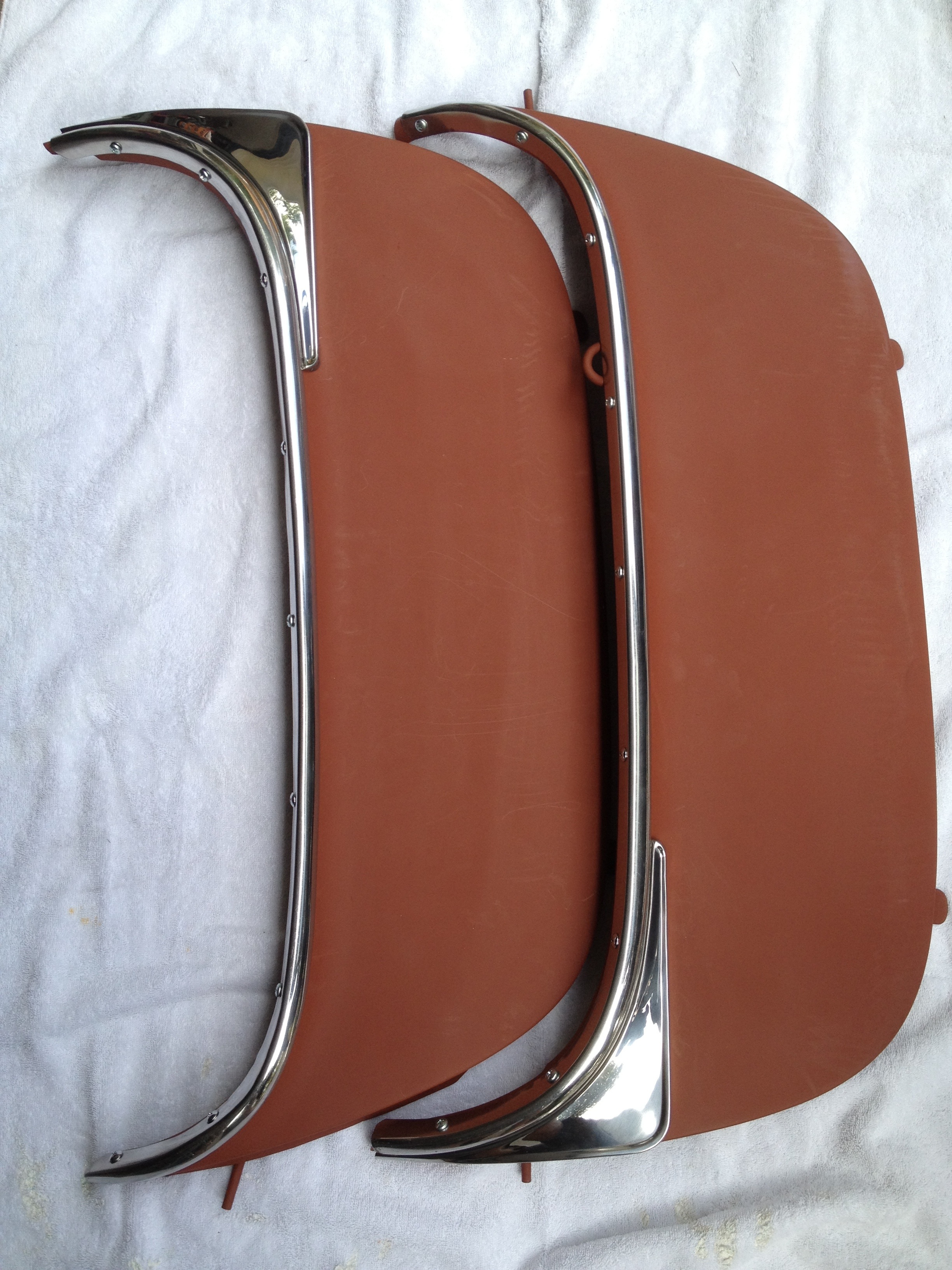

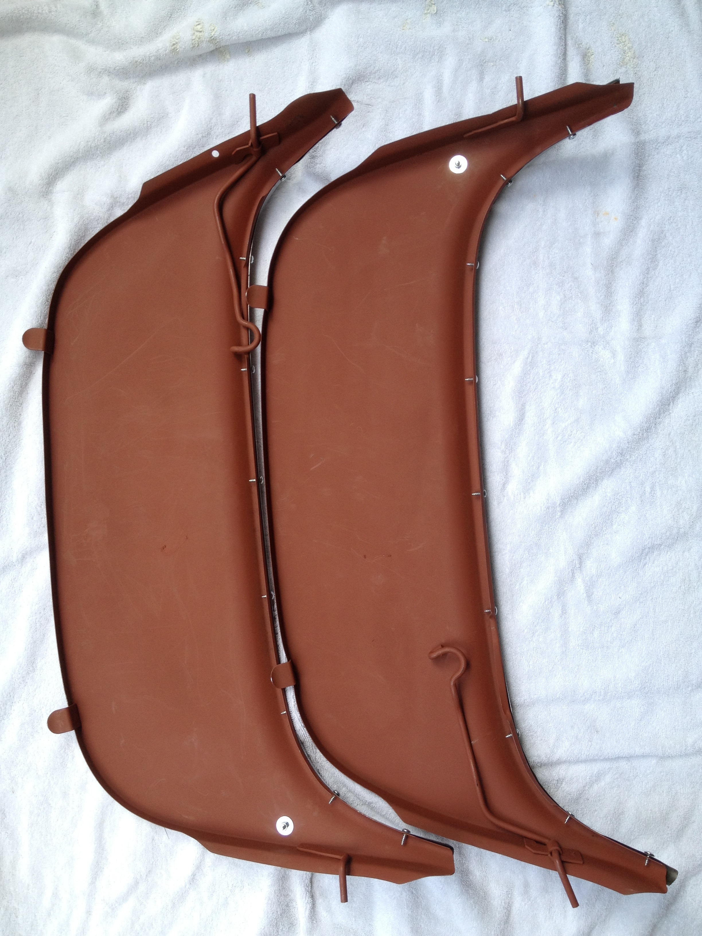

Who knows *what* they've done, but here's a site with some decent pictures, both sides, of both L and R skirts so you can see what sort of parts *should* be there. Note that these are missing the rubber gasket that goes on the top to separate them from the fenders.
Thanks to all, I now see what is wrong with mine. Now to get the right hardware in place is my next challenge.
